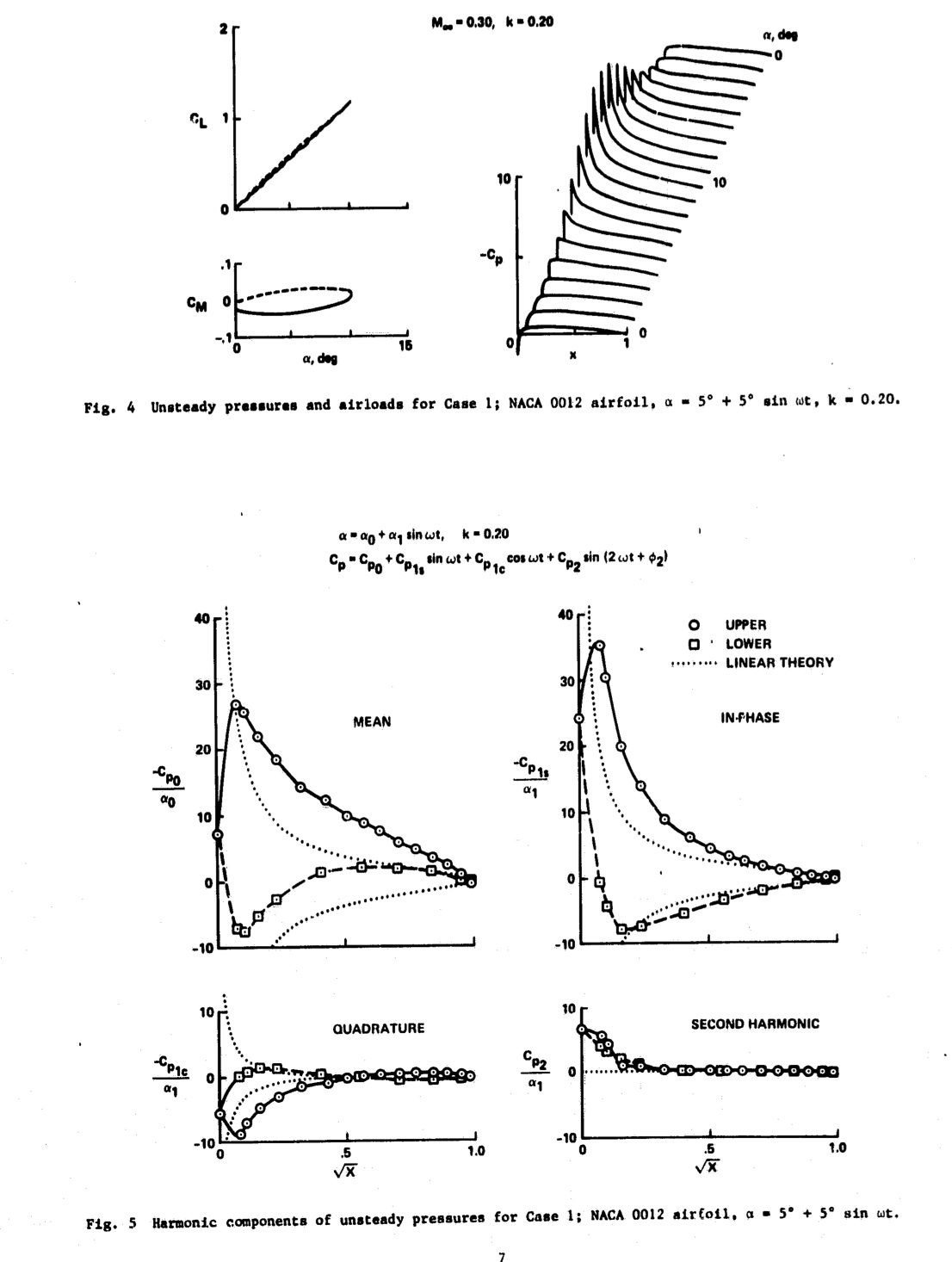

The problem is I need it for airfoils. At the moment I am using a NACA 0012 and the experimental data with which I need to validate the code is this sinusoidal pitch motion:
5° + 5*sin(wt)

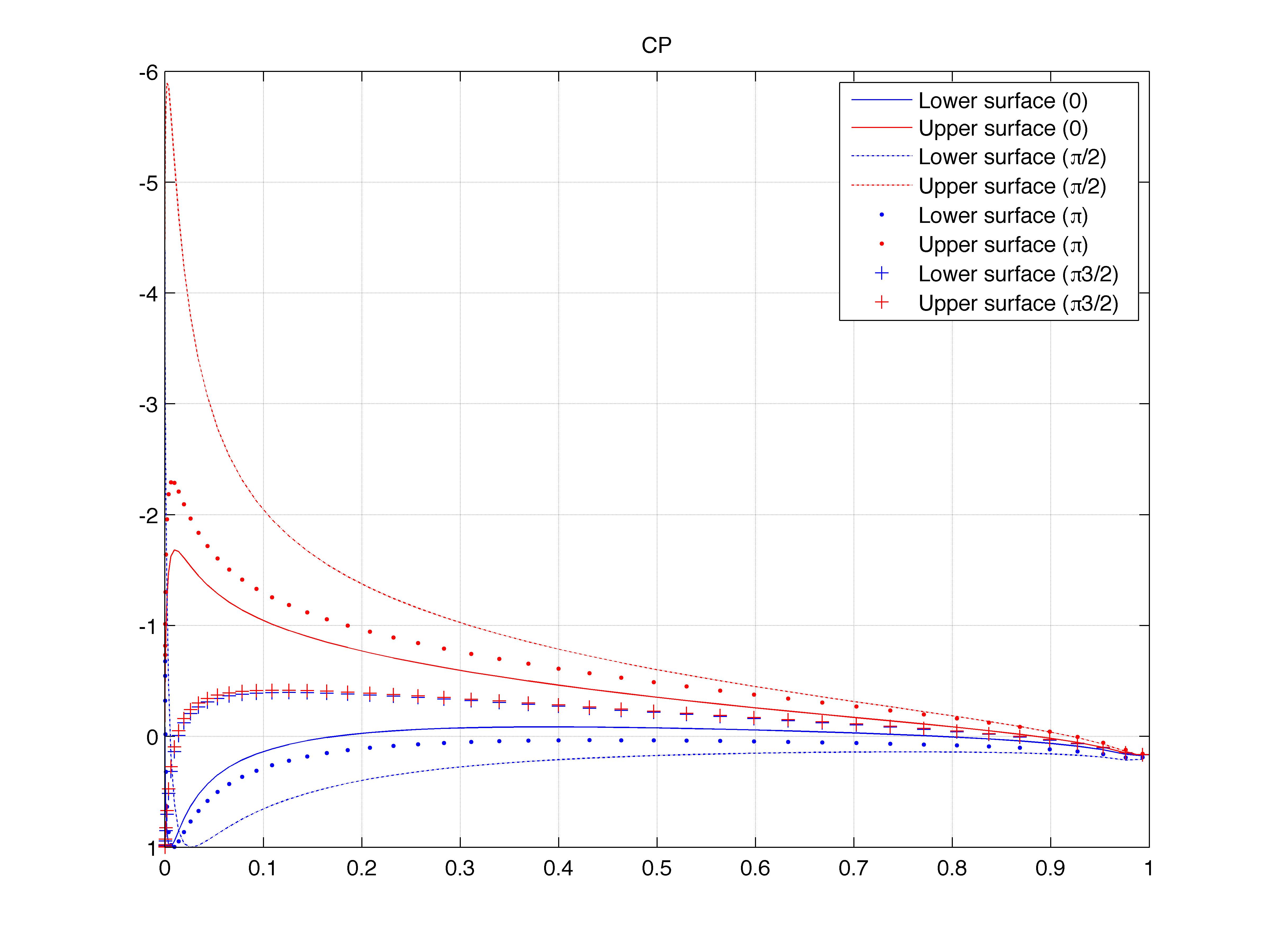

Things now are quite differente and Cp variations seem to be more realistic: for the mentioned case they go from 0 to approx -6.
Answering to a few questions posed by blackjack:
- I am interested in the Cp, above all;
- I still calculate it via the tangential component of the velocity at each collocation point, without considering the potential's derivative, also because I still don't understand how to (from the gamma or from other quantities) obtain it... should I integrate the gammas on the airfoil to obtain PHI, and then differentiate (= dPHI/dt == (PHI_k-PHI_k-1)/(t_k-t_k-1)) to get the second term of the RHS in "Cp=1-V^2+2d(phi)/dt"... or am I wrong?
- I have this file http://http://www.ar87.com/uni/19810...1981008464.pdf
and at page 7 you can see the data I am trying to get out of my code. So reduced frequency k is 0.2.
What I now get as variations of my Cp is this:
http://www.ar87.com/uni/dCp.jpg

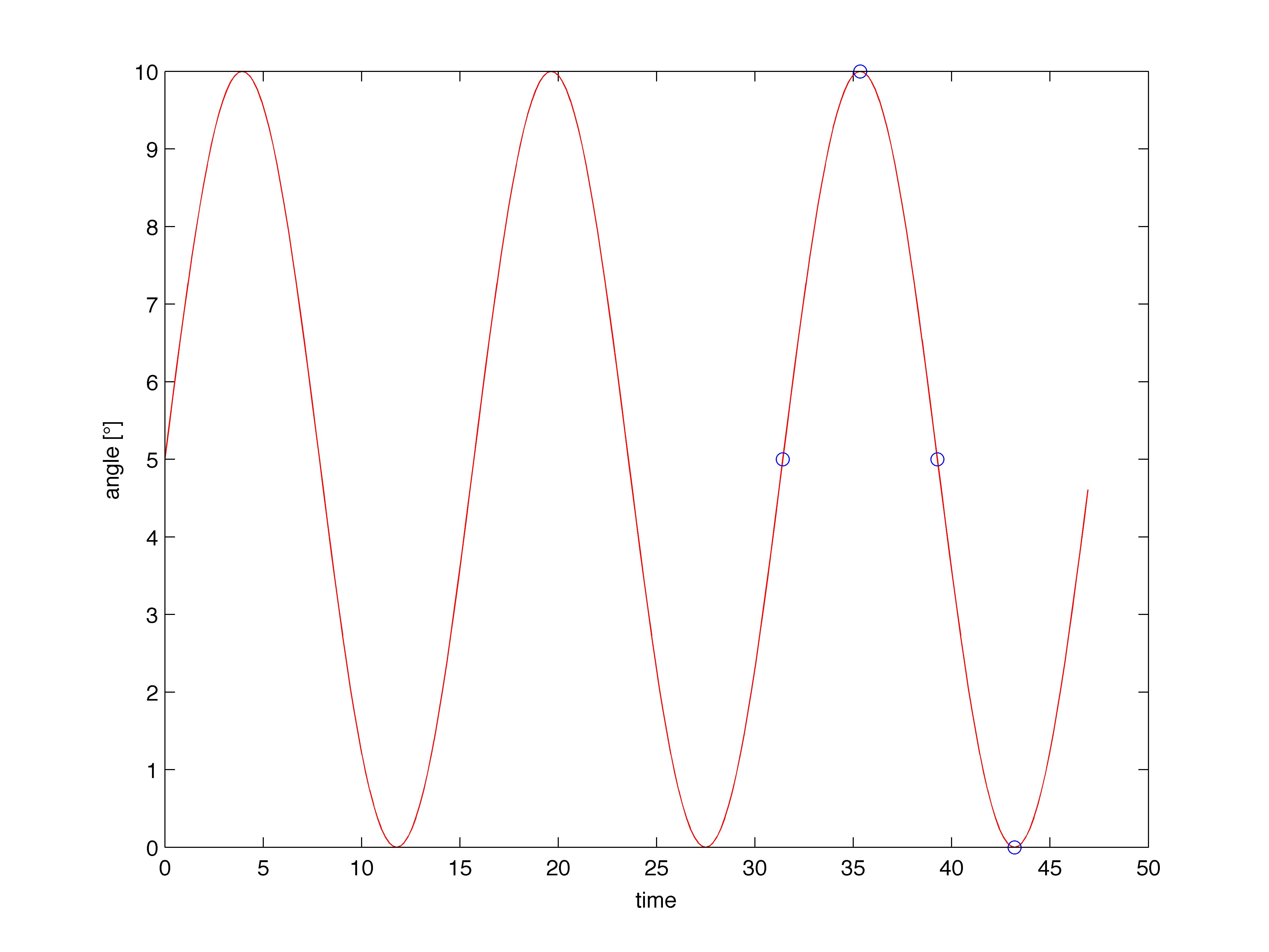

which corresponds in the time line to these points:
http://www.ar87.com/uni/angle.jpg
(I just plotted those 4 points).

Ok, the test case (experimental data) is this one (the link which wasn't working before):
http://www.ar87.com/uni/testCase.jpg

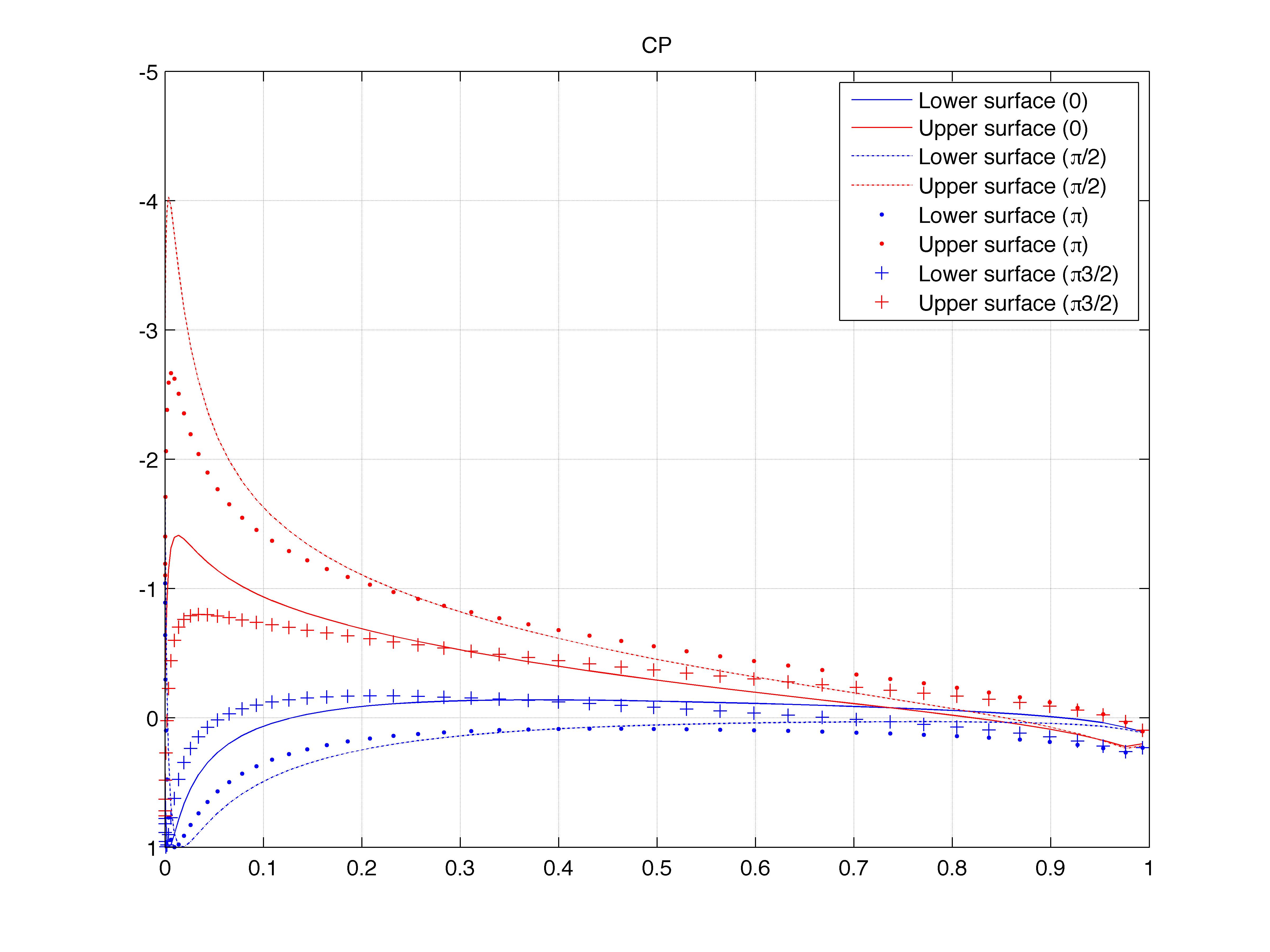

I have modified my code by adding a function which moves the vortices in the wake under the influence of the induced effect (panel induced velocity and wake self-induced velocity), and the same case produces this:
http://www.ar87.com/uni/dCp1WRUit.jpg
this is again the plot of 4 points on the sinusoidal motion: 0, pi/2, pi, 3/2pi.
I didn't manage to implement the dPHI/dt... how exactly should I calculate it?

6) solve the system
The problem seems that the Cp variations are not big enough. I am using a NACA report on wind tunnel experimental data (pitching motion 5 + 5sin(Wt) motion) to check the code. But also the comparison with results contained in the Katz and Plotkin (plot of CL-ALPHA of a 0012) isn't satisfactory.
I compute the Cp at each collocation point via the formula:
Cp_i = 1 - Vel_i^2
where Vel_i is the velocity at the i-th collocation point obtained from the different contributes: free stream (similar to steady state) + kinematic movement (sinusoidal motion) + induced velocities (by panels and by wake).
I consider the free stream V to be equal to 1.Honestly I am not quite sure that all of this is right (talking about Cp calculation).
Moreover I have great doubt about the Kutta condition: in the steady state case the last line of matrix A is set equal to: [1 0 0 0 . . . 0 1] so that vorticity at T.E. is 0:
gamma_1 + gamma_(N+1) = 0
I did not change this in the unsteady code only because I couldn't find any indication on how to modify it (the book says that for small oscillations the steady case condition should still work fine).
I would be really thankful if any of you could help me out, as it is more than a month that I am trying to solve the problem. I have also read many articles like Hancock and Mook's one, or similar, but they don't really say explicitly how to do things.
Thank you very much.
PS: do ask questions if you don't understand some of the procedures I have used, I will be happy to explain more thoroughly.
Hi Anthony,
I've come across your post as I'm developing a 2D unsteady panel method for aerofoils too by following the Katz and Plotkin book. I'm doing this in a framework for gust reconstruction; do you still have your code available and if so could you please share it with me?
Thank you!
