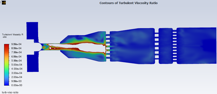

During iteration it appears this message: turbulent viscosity limited to viscosity ratio of 1e05 in 37 cells. Can someone explain me the meaning of this message and if I have to do something? Furthemore there is reversed flow in the outlet, problably caused by the extension of the domain; it affects the final result? Thank you very much to everyone bye bye

Hi, the message means that the ratio of the turbulent viscosity and the laminar viscosity exceeds 100000. The ratio defines a limitation between the two viscosities that you can change in the limitation panel of fluent. But this is not recommandable. You have to take care that the limitation is not around the examination area of your flow. When it is in the first iteration steps you should wait some further steps and it will disapear by itself. The reversed flow can affect your solution if it is nearby your interessting flow area because you don't resolve the real situation of e.g. a separtion.

Although the warning has disappeared, you may want to plot your turbulent viscosity ratios at various planes, and verify that they are still not too high.

Thank you Chetan Kadakia for the post but how much is high? I mean what value of turbulent viscosity ratio is considered too high? thank you very much in advance for your response

It's hard to say... maybe a 1000? I'm not really sure.
You have to plot it and compare. Plus it is problem dependent. Flow in a jet engine versus flow in a pipe will obviously vary.
In the near wall region, you will high molecular viscosity, and therefore not necessarily a high ratio. But perhaps in the wake where you are away from surfaces, and vortex shedding is high, you may have higher turbulent viscosities in that region.
Plot contours of this value just to take a look at it. If your problem is 3D you will need to create a plane or two. You can email me a picture of the contour, if you want my judgement.

I was getting the same problem as mentioned earlier. That is just a warning and will not affect your final results.. But you need to maintain quality of your mesh. You can disable it by increasing the maximum turbulent viscosity ratio to greater extent.
Solution Controls-->Limits-->Maximum Turb. viscosity Ratio (add two or more zeroes.)..

Sorry but this is very bad advice. The warning in place because having that high of a viscosity ratio is not physical. This means there is something wrong with the setup, mesh, or boundary conditions etc. Increasing the limit will remove the error message but the unrealisitc, bad solution will still be there. I hope people reading this will have a deeper search into the forums because there are a lot of good tips to resolve common errors that cause this warning. Above hwangpo has linked 2 good threads on this topic which are a great starting place
