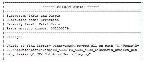

I am trying to use pmv and ppd function of comfort factor in cfx for use in HVAC simulations. but the help document of ANSYS (CFX) is not useful and there is no complete guide. are there any document or guids?
When we import "comfort-factors.ccl" in CFX-Pre, at next part (solver manager), the below error is appear: http://bayanbox.ir/id/2345786180698733734 |
