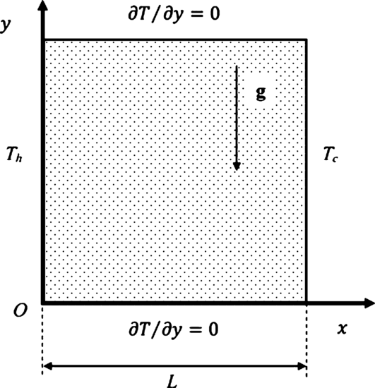

I'm new to openFOAM and thought of checking if OF gives the right value of the Nu for laminar flow through a pipe.
I used the buoyantBoussinesqSimpleFoam solver by turning off turbulence and g (so that the buoyancy effects are turned off). The velocity and temperature fields seem correct. Now, I want to check the Nu. I tried creating the function NusseltCalc() as detailed in one of your previous posts. However during compilation, I'm getting an error. I tried compiling the wallHeatFlux function as well just to check if it compiles properly (obviously by creating a copy of it first). Even that is giving the same error. In fact even when I tried adding temperature field to icoFoam and tried compiling, its giving me the same error.
Here's the error message I'm getting

If someone wants to implement the code of Johan Magnusson (shown in post #3) in OpenFOAM 4.1, one only need to change
Code:
forAll(wall_localNusselt.boundaryField(),patchi
     wall_localNusselt.boundaryField()[patchi] = length*
               patchHeatFlux[patchi]/((T_hot-T_ini)*k);
to
Code:
forAll(wall_localNusselt.boundaryFieldRef(),patchi
     wall_localNusselt.boundaryFieldRef()[patchi] = length*
and everything works fine.
A detailed description of the implementation is given in his report
("conjugateHeatFoam with explanational tutorial together with a buoyancy driven flow tutorial and a convective conductive tutorial")
student666, djamila77 and Pavithra like this.

hello everyone,
is there anyone who can help me?!
How can i calculate the local Nusselt number for a vertical wall in cavity using a Matlab implimentation?
chberbelali is offline   Reply With Quote

Originally Posted by piu58 View Post
The Nußelt number is connected to the thickness of the boundary layer d. If you may measure this thickness, you may calculate the Nußelt number stepwise (but not pointwise). You have to select al length along L the surface for which you plan getting Nu. The you have
Nu = L / d
Details here:
Nusselt number
Matlab: Local nusselt number computing
My problem figure:
Best regards
