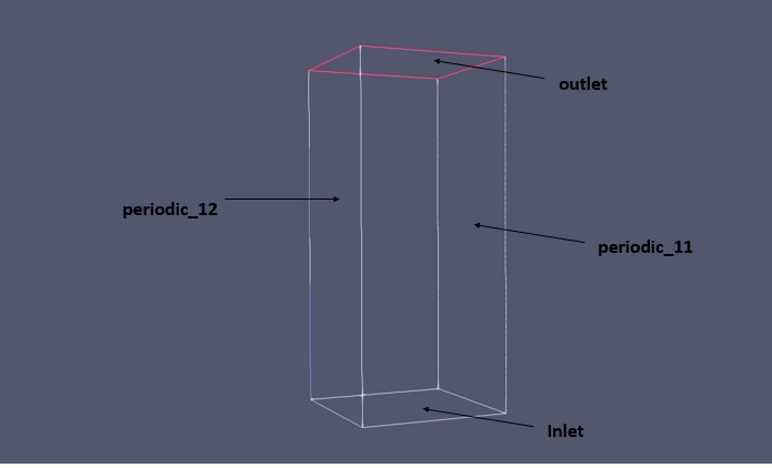

November 13, 2023, 09:19 |
mass loss issue
#299 |
Join Date: Jun 2018
Posts: 20
Rep Power: 8 |
Hello all,
I looked through the forum but could't find a solution to my AMI problem: I am solving diffusion-like scalar transport equations and face significant mass loss. In a simplified sketch, the mesh looks like this: With an inlet and an outlet (z-coordinate) and two periodic directions (x, y). I managed to run several geometries with the cyclicAMI bc. I just figured that I loose 10-30% of mass until the end of the simulation. I believe this is caused by the slightly different sizes (~3%) and non-conformal meshes of the periodics because mass conservation works with zeroGradient bcs. The boundary file looks like this: Code:
periodic_11 { type cyclicAMI; inGroups 1 ( cyclicAMI ); nFaces 6012; startFace 1380532; neighbourPatch periodic_12; transform translational; separationVector ( 0 3e-05 0 ); matchTolerance 1e-07; AMIMethod faceAreaWeightAMI; requireMatch 1; restartUncoveredSourceFace 1; lowWeightCorrection 0.2; } periodic_12 { type cyclicAMI; inGroups 1 ( cyclicAMI ); nFaces 5299; startFace 1386544; neighbourPatch periodic_11; transform translational; separationVector ( 0 -3e-05 0 ); matchTolerance 1e-07; AMIMethod faceAreaWeightAMI; requireMatch 1; restartUncoveredSourceFace 1; lowWeightCorrection 0.2; } Has anyone solved this issue?? So far I played with the settings without success. I tried the cyclicPeriodicAMI but it throws a sigSegv error which I don't understand: Code:
#0 Foam::error::printStack(Foam::Ostream&) at ??:? #1 Foam::sigSegv::sigHandler(int) at ??:? #2 ? in /lib/x86_64-linux-gnu/libpthread.so.0 #3 __dynamic_cast in /lib/x86_64-linux-gnu/libstdc++.so.6 #4 Foam::coupledPolyPatch const& Foam::refCast<Foam::coupledPolyPatch const, Foam::polyPatch const>(Foam::polyPatch const&) at ??:? #5 Foam::cyclicPeriodicAMIPolyPatch::resetAMI() const at ??:? #6 Foam::cyclicAMIPolyPatch::AMI() const at ??:? #7 Foam::cyclicAMIPolyPatch::applyLowWeightCorrection() const at ??:? #8 Foam::cyclicAMIFvPatchField<double>::patchNeighbourField() const at ??:? #9 Foam::coupledFvPatchField<double>::evaluate(Foam::UPstream::commsTypes) at ??:? ... Any help is appreciated! |
