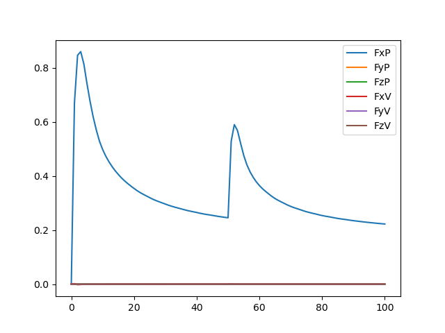

Let's for instance use the motorBike example. I replaced the motorBike object by a thin plate to get a simple example.
If I run the simulation for, let say 50s (setting endTime to 50) wait for the simulation to stop and resume it, it works but I have a "spike" in the forces.dat data (see the image in the link bellow. I don't know how to insert an image hosted in a htpps web site)
https://i.postimg.cc/ZK9TnDQB/Figure-1.png
I must do something wrong somewhere.
I use the Allrun script to start at first the simulation with endTime set to 50 and startTime set to 0 in the controlDict file.
To resume the simulation, I set endTime to 100, startTime to 50 in controlDict.
I remove log.potentialFoam, log.simpleFoam, log.reconstructParMesh and log.reconstructPar
Then I launch the simple following script which is nothing but the end of Allrun:
