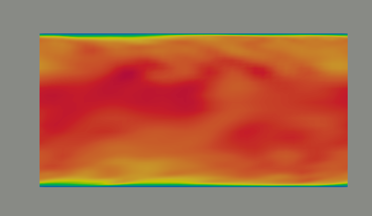

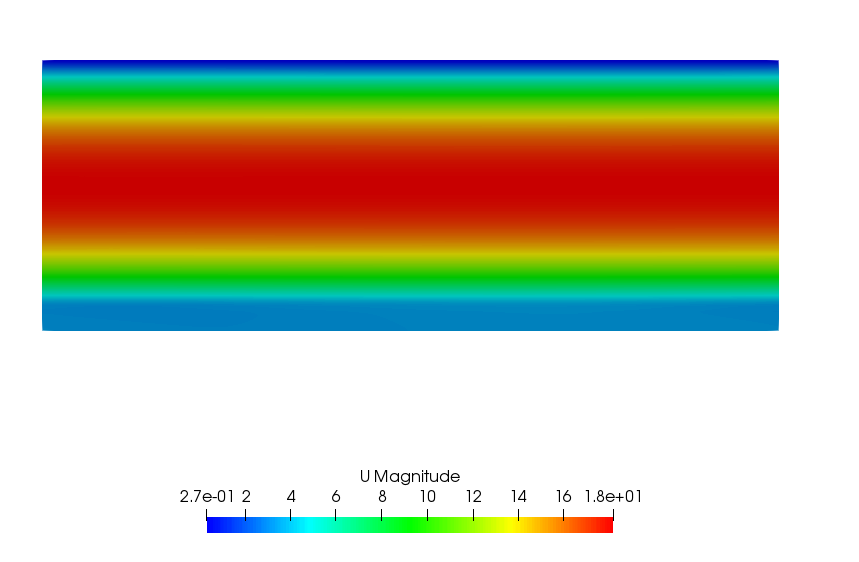

/*--------------------------------*- C++ -*----------------------------------*\ ========= | \\ / F ield | OpenFOAM: The Open Source CFD Toolbox \\ / O peration | Website: https://openfoam.org \\ / A nd | Version: 8 \\/ M anipulation | \*---------------------------------------------------------------------------*/ FoamFile { version 2.0; format ascii; class volScalarField; location "1"; object p; } // * * * * * * * * * * * * * * * * * * * * * * * * * * * * * * * * * * * * * // dimensions [1 -1 -2 0 0 0 0]; internalField uniform 0; boundaryField { inlet { type cyclicAMI; } outlet { type cyclicAMI; } Top { type zeroGradient; } right { type cyclicAMI; } left { type cyclicAMI; } Ridges { type zeroGradient; } Wall_below { type fixedValue; value uniform 0; } air_inlet { type cyclicAMI; } air_outlet { type cyclicAMI; } Right_air { type zeroGradient; } Left_air { type zeroGradient; } } // ************************************************************************* // have anyone could give me the advices when I using fvoptions what is an error and how to create the fluctuation velocity (full developed turpulent) in DNS simulation? the result which I want to achieve like the picture but for two-phase flow (this is sigle flow) sincerely Thank you for any advice! |
