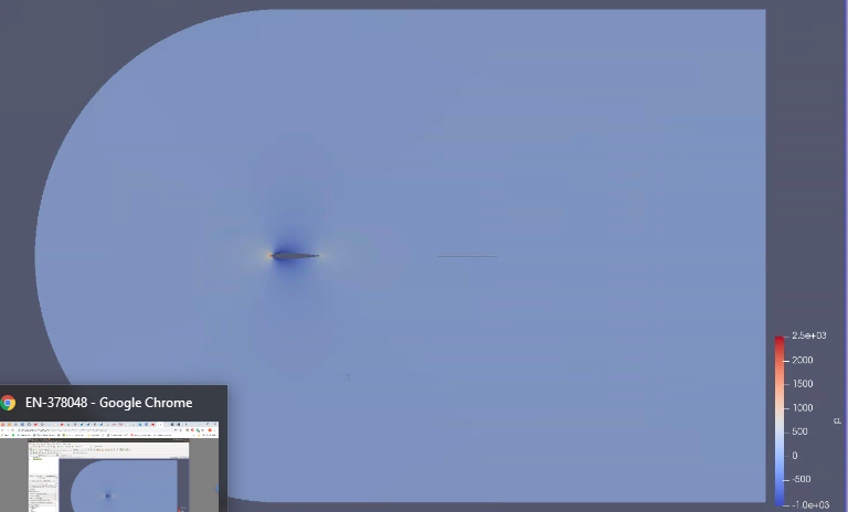

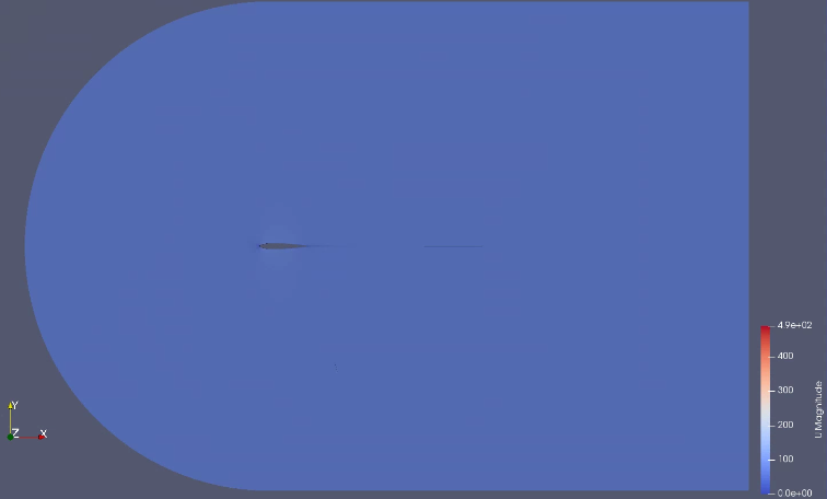

I am trying to run les simulation for flow over Naca0012 using WALE subgrid model.I first created the 3-D domain and run the case for steady state case using simpleFoam and then i used the converged solution as initial solution for the les by renaming the folder (6000 to 1e-5) then i decomposed the domain. I am using pimpleFoam for les simulation but the problem is that the simulation is not converging and the pressure equation solver reach the maximum no fo iteration (1000)without reaching a converged solution.
Is there any examples or have anyone worked on les for aerofoil ?
This the RANS results which is set as initial value for les
the velocity fields
pressure fields
after running les simulation for few time step results seems to be not converged
the velocity field
pressure field
boundary conditions

the log files for the solver

Old   October 9, 2019, 09:01
Lilian Chabannes
Join Date: Apr 2017
Posts: 58
Rep Power: 9
Lookid is on a distinguished road
some comments that I hope will help:
1) Use delta cubeRootVol for WALE, no need for vanDriest damping (https://caefn.com/openfoam/wale-sgs-model)
2) Try using PIMPLE as PIMPLE, not PISO, it will definitely help the pressure converge. i.e. put a lot of nOuterCorrectors + Residual goal. You will go to the next timestep once the specified residual is attained. Below is what I used for a LES simulation. You should have quite a lot of loops at first, but it should reduce a lot once it's stable. After 5 pimple loop it converges for my case. But I am not an expert at all, it is my first case.
Code:
PIMPLE
    nOuterCorrectors 50;
    nCorrectors     2;
    nNonOrthogonalCorrectors 2;
    pRefCell        0;
    pRefValue       0;
    outerCorrectorResidualControl //(or residualControl, depends on the version of OF)
        p { tolerance 1e-4; relTol 0;} // I was said 1e-4 is enough
        U { tolerance 1e-5; relTol 0;}
3) in fvSchemes, something that helped me a bit is using 'filteredLinear2 0.3 0' for scalars and 'filteredLinear2V 0.3 0' for U. You introduced a bit of upwind to stabilize some potential sh**, while keeping a central difference behaviour.
Please keep an update of how it is going
Feel free to join the OpenFOAM Discord https://discord.gg/P9p9eHn, a live chat about OpenFOAM
Lookid is offline   Reply With Quote
Unless your grid is pretty much garbage you don't need such "over-relaxation" of the solution. 50 outer iterations it's too much, specially if you're running big cases (50 times the solution of the pressure equation? Good luck with that). Besides, a naca profile is a very simple case, and one should be able to build a grid with optimum quality.
One thing: A proper LES (explicit) must avoid low-order upwinding, if you want your model to be accountable for most of the residual dissipation. Otherwise you are just doing "part explicit part implicit" LES which, when mixed, mean absolutely nothing.
Santiago is offline   Reply With Quote
Old   October 9, 2019, 10:34
Lilian Chabannes
Join Date: Apr 2017
Posts: 58
Rep Power: 9
Thank you for the clarifications
It is an arbitrary number never reached, I could have 10000 there. The point is to have the residual converged, and it never takes long as said. That being said, is it still a bad thing to do? Or LES should always be PISO?
I used the filteredLinear thingy because I had this wavy pattern (Dicretization schemes in LES (pitzDaily)). As I understood it's appears if too coarse mesh and it shouldnt appear when Pe<2, not sure though. Otherwise yes, Gauss linear if this problem isn't here.
Old   October 9, 2019, 10:40
zein elserfy
Join Date: May 2018
Posts: 25
Rep Power: 8
zeinelserfy is on a distinguished road
Thanks for you reply Lilian Chabannes
I will try your recommendations

zeinelserfy is offline   Reply With Quote
Old   October 9, 2019, 20:40
zein elserfy
Join Date: May 2018
Posts: 25
Rep Power: 8
you mean that if the number of outer iterations is high this means that there is a problem with the mesh or it needs to be refined ??
which scheme should be used with les?
Old   October 9, 2019, 22:12
zein elserfy
Join Date: May 2018
Posts: 25
Rep Power: 8
Code:
PIMPLE
    nCorrectors     2;
    pRefCell        0;
    pRefValue       0;
I have set residual control for the outeriterations but after 1 time step
the solver crashed
Code:
zels496@en-cer00228:/data/cases/LES/naca0012-4initiaRANS/case1$ mpirun -np 16 pimpleFoam -parallel >log
[en-cer00228:06917] 15 more processes have sent help message help-mpi-btl-base.txt / btl:no-nics
[en-cer00228:06917] Set MCA parameter "orte_base_help_aggregate" to 0 to see all help / error messages
[3] #0  Foam::error::printStack(Foam::Ostream&) at ??:?
[3] #1  Foam::sigFpe::sigHandler(int) at ??:?
[3] #2  ? in /lib/x86_64-linux-gnu/libc.so.6
[3] #3  Foam::GaussSeidelSmoother::smooth(Foam::word const&, Foam::Field<double>&, Foam::lduMatrix const&, Foam::Field<double> const&, Foam::FieldField<Foam::Field, double> const&, Foam::UPtrList<Foam::lduInterfaceField const> const&, unsigned char, int) at ??:?
[3] #4  Foam::GaussSeidelSmoother::smooth(Foam::Field<double>&, Foam::Field<double> const&, unsigned char, int) const at ??:?
[3] #5  Foam::smoothSolver::solve(Foam::Field<double>&, Foam::Field<double> const&, unsigned char) const at ??:?
[3] #6  Foam::fvMatrix<Foam::Vector<double> >::solveSegregated(Foam::dictionary const&) at ??:?
[3] #7  Foam::fvMatrix<Foam::Vector<double> >::solveSegregatedOrCoupled(Foam::dictionary const&) at ??:?
[3] #8  Foam::fvMesh::solve(Foam::fvMatrix<Foam::Vector<double> >&, Foam::dictionary const&) const at ??:?
[3] #9  ? at ??:?
[3] #10  __libc_start_main in /lib/x86_64-linux-gnu/libc.so.6
[3] #11  ? at ??:?
[en-cer00228:06924] *** Process received signal ***
[en-cer00228:06924] Signal: Floating point exception (8)
[en-cer00228:06924] Signal code:  (-6)
[en-cer00228:06924] Failing at address: 0x335bd92400001b0c
[en-cer00228:06924] [ 0] /lib/x86_64-linux-gnu/libc.so.6(+0x354b0)[0x7fa21dba24b0]
[en-cer00228:06924] [ 1] /lib/x86_64-linux-gnu/libc.so.6(gsignal+0x38)[0x7fa21dba2428]
[en-cer00228:06924] [ 2] /lib/x86_64-linux-gnu/libc.so.6(+0x354b0)[0x7fa21dba24b0]
[en-cer00228:06924] [ 3] /data/openFOAM/OpenFOAM-v1906/platforms/linux64GccDPInt32Opt/lib/libOpenFOAM.so(_ZN4Foam19GaussSeidelSmoother6smoothERKNS_4wordERNS_5FieldIdEERKNS_9lduMatrixERKS5_RKNS_10FieldFieldIS4_dEERKNS_8UPtrListIKNS_17lduInterfaceFieldEEEhi+0x347)[0x7fa21ef0e4e7]
[en-cer00228:06924] [ 4] /data/openFOAM/OpenFOAM-v1906/platforms/linux64GccDPInt32Opt/lib/libOpenFOAM.so(_ZNK4Foam19GaussSeidelSmoother6smoothERNS_5FieldIdEERKS2_hi+0x28)[0x7fa21ef0e688]
[en-cer00228:06924] [ 5] /data/openFOAM/OpenFOAM-v1906/platforms/linux64GccDPInt32Opt/lib/libOpenFOAM.so(_ZNK4Foam12smoothSolver5solveERNS_5FieldIdEERKS2_h+0x6ed)[0x7fa21ef05a3d]
[en-cer00228:06924] [ 6] /data/openFOAM/OpenFOAM-v1906/platforms/linux64GccDPInt32Opt/lib/libfiniteVolume.so(_ZN4Foam8fvMatrixINS_6VectorIdEEE15solveSegregatedERKNS_10dictionaryE+0x5d3)[0x7fa222f1f893]
[en-cer00228:06924] [ 7] /data/openFOAM/OpenFOAM-v1906/platforms/linux64GccDPInt32Opt/lib/libfiniteVolume.so(_ZN4Foam8fvMatrixINS_6VectorIdEEE24solveSegregatedOrCoupledERKNS_10dictionaryE+0x408)[0x7fa222f2c4b8]
[en-cer00228:06924] [ 8] /data/openFOAM/OpenFOAM-v1906/platforms/linux64GccDPInt32Opt/lib/libfiniteVolume.so(_ZNK4Foam6fvMesh5solveERNS_8fvMatrixINS_6VectorIdEEEERKNS_10dictionaryE+0x23)[0x7fa222ed5e33]
[en-cer00228:06924] [ 9] pimpleFoam[0x426521]
[en-cer00228:06924] [10] /lib/x86_64-linux-gnu/libc.so.6(__libc_start_main+0xf0)[0x7fa21db8d830]
[en-cer00228:06924] [11] pimpleFoam[0x428589]
[en-cer00228:06924] *** End of error message ***
I do not know what is the cause of that problem, but seems something related to linear equation solver
