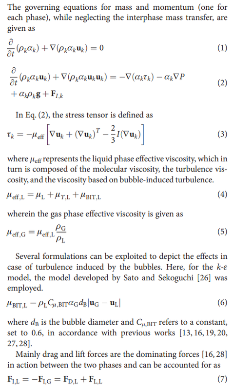

I'm having doubts about how to implement a 'Coded Source' that adds the BIT terms (drag force, lift force, virtual mass,...) to the continuity equation. Has anyone done this and could share? IMAGE |
