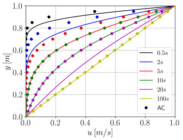

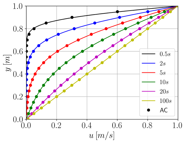

I am implementing the Artificial Compressibility (AC) and Fractional-Step Pressure Projection (FS-PP) method into OpenFOAM. For laminar flows, they work well and I can validate them against benchmark cases. Next, I wanted to add turbulence and added the turbulence->divDevReff() object, which in turn is adding the viscous and Reynolds stresses. So I removed the laplacian operator from my momentum equation but then get different results.
For the AC method, it seems my results are correct when I add the laplacian to the momentum equation, but for the FS-PP method, it seems to work only if I remove the same operator. If I reverse this, i.e. remove the laplacian from the AC method and add it to the FS-PP method, I am getting incorrect results.
I am testing the couette flow as a test case and I am adding the dual time stepping to the AC method to get a correct time behaviour. This is, for the moment, a laminar test case and turbulence is switched off.
Solving the AC method with the following momentum equation:
Code:
fvVectorMatrix UEqn
fvm::ddt(U)
+ fvm::div(phi, U)
+ turbulence->divDevReff(U)
- fvm::Sp(dualTime.SpCoefficient(), U)
+ fvc::Sp(dualTime.SuCoefficient(), dualTime.Su())
results in (solid lines represent the analytic solution in 2D for laminar flows (here Re=100) and the dots correspond to the numerical solution. Same coloured dots / lines correspond to the solution obtained at the same time):
If I change the momentum equation to include the viscous term, i.e. solving
Code:
fvVectorMatrix UEqn
fvm::ddt(U)
+ fvm::div(phi, U)
- fvm::laplacian(turbulence->nuEff(), U)
I get
So it seems that the correct solution is obtained including the laplacian (which is odd as the turbulence->difDevReff() is including the same term.

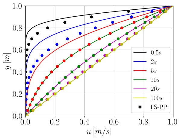

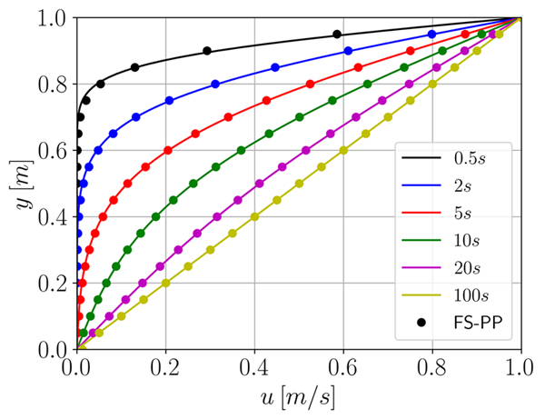

For the FS-PP method, it is the opposite behaviour, i.e. if I solve the momentum equation without laplacian, i.e.
Code:
fvVectorMatrix UEqn
fvm::ddt(U)
+ fvm::div(phi, U)
I get
and if I include the laplacian, i.e. solving
Code:
fvVectorMatrix UEqn
fvm::ddt(U)
+ fvm::div(phi, U)
I get
which demonstrates that the correct behaviour is seemingly obtained with the laplacian for the AC method but without for the FS-PP method.
It seems that the FS-PP implementation is correct as the laplacian term is included only once and that there is something wrong with the AC method. The source term in the AC method is simply the contribution of the real time derivative, i.e. in the simplest case the backward Euler scheme as (U^n+1 - U^n) / dt. Here, both Sp and Su coefficients are 1/dt and Su itself is U^n. Substituting that back into the momentum equation will reconstruct the time derivative as given above.
