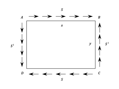

Old   May 10, 2013, 09:54
  #36
Yosmcer Mocktai
Join Date: Apr 2013
Location: Behind a computer
Posts: 50
Rep Power: 17
Yosmcer will become famous soon enough
I know this post is old, but it is the best one I found related to my problem.
I have a wall that is parallel to the X axis, flow is laminar.
I compute the wallShearStress, and have a result.
I use paraFoam to look at this with Paraview.
I plot over line the wallShearsStress by placing the line on the boundary.
I see that I have a value for the magnitude of the wallShearStress, and three others values, one for each direction.
As my face is parallel to the X axis, I expect to have a signed value in the X direction, a value approximating zero in the two other direction, and the absolute value of the X's direction value.
But I also have a Y direction value, so a normal compound to the face. And this value is not negligible (the z value is negligible, but no flow in this direction).
The magnitude is the vectorial sum of the X and Y values (without the sign).
[EDIT]
I think this is because the shears stress must equilibrate at edges. So there is a normal compound corresponding to the tangential one of the perpendicular face, and a continuity of this across the face.
Image from : http://www.codecogs.com/reference/en...ear_stress.php
So, considering the AB face, there is a normal compound to this face at the points A and B, but opposite, so there must be a continuous field across the face, and the resulting shear stress in not totally tangential to the face.
Please, correct me if there is/are mistake(s).
[\EDIT]
Yosmcer is offline   Reply With Quote
