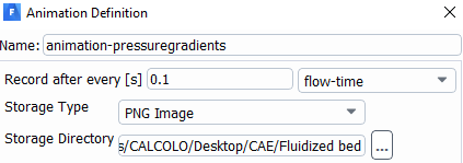

Old   September 20, 2022, 07:51
Gioacchino La Rochelle
Join Date: Jul 2016
Posts: 19
Rep Power: 10
Gioacchino La Rochelle is on a distinguished road
png is now supported
And I think it works great, but I have experienced an issue.
I am using an adaptive timestepping (varying from 1e-5s to 1e-3s), flow time 60s (calculation finished) recording every 0.1s as reported below.
Although these settings, the final video realized with Animation > Playback is 37s not 60s.
Gioacchino La Rochelle is offline   Reply With Quote
