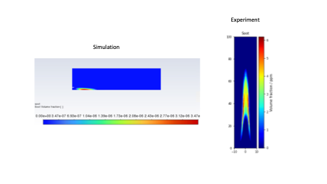

I am modeling a C2H4/O2 laminar diffusion flame in ANSYS fluent and want to evaluate the soot formation process of the field. In comparison with the experiment data, the magnitude of the soot peak volume fraction is correct, but the contours show a significant difference between the simulation and experiment.

Here is my simulation result and experiment result.
Forgive the ugly layout XD.
https://i.postimg.cc/T2SXtGy7/compare.png
It is pretty obvious, that the peak of the soot volume fraction should locate at the boundary (or the "wing"?) of the flame, not the center. But no matter how I change my model, the soot shape doesn't change.
