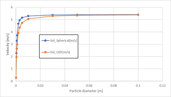

I am trying to get an udf working for a modified particle drag. As a testing experiment, I am running some simulations trying to mimick the Morsi-Alexander Drag Law with an UDF. Running the test case, where I simply have a straight pipe with the default Fluent code and with my UDF, I am not getting the same values, and I don't really know why... The code I have used is below.
At this thread they claim that it works, but I don't really know how they managed...
The deviation I get from using the UDF or the Fluent embedded code is shown in the figure:
Any ideas??
Thanks and regards.

Did you find a solution? I have similar code and the results are about the same for some particle sizes but quite off for others

Unfortunately did not, sorry.
