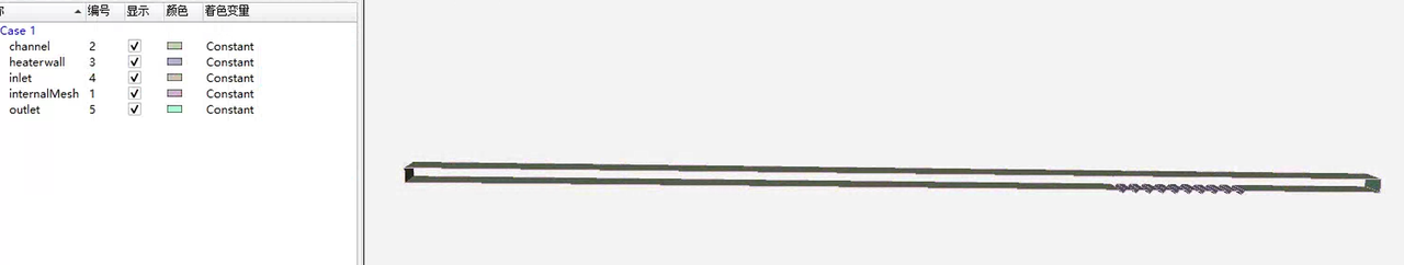

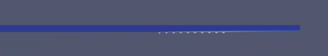

Hi,all.I have a question about the foamToEnsight .I was dealing with a 2Dcaes(the fornt and back face(perpendicular to Z dicrection)were set as "empty"),when I use paraview ,all the result can be seen,including the velocity field and temperature field of the empty face.(showed as figure1.)
But after run the foamToEnsight ,and use Ensith to open the case,the empty faces were missing ,so that I can only see the boundary of the field(showed as figure2.) Is there any method to export the result of the empty faces and the inrernal zone ? Any help will be appreciated!! |
