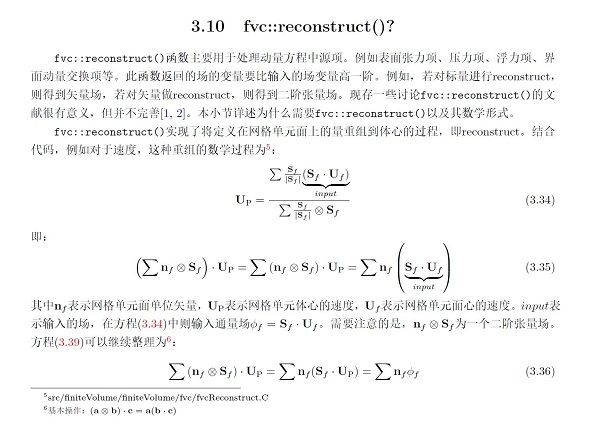

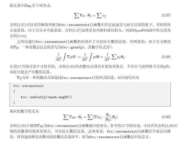

1. The fvc::reconstruct() function was used to smooth oscillation by combining usage of fvc::snGrad(). Typically you can write either 1) fvc::grad(p) or 2) fvc::reconstruct(fvc::snGrad(p)*mesh.magSf()). But the result is different. The first method uses a extended stencil whereas the second one employs a compact stencil. Thereafter the oscillation can be avoided by the second one (fvc::reconstruct method). Similar technique can be also found if you think why we discretize the laplacian term as fvc::laplacian() instead of div(grad()).
2. What it do is simply \sum U_p \cdot S_f = \sum phi, the reason you see there is because inv() function cannot handle velocity. 3. The order of it is influenced by the scheme of snGrad function. Therefore, orthogonal grids provide the best accuracy. ![]() ![]()
